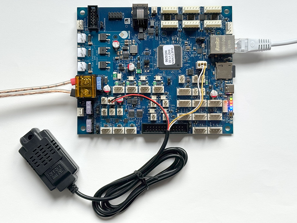

Image: A Duet 3 Mainboard 6XD v1.02 connected to a Modbus RTU temperature and humidity sensor, using the built-in RS485 adapter.

In the following sections, an XY-MD01 environment sensor, which measures temperature and humidity, is used as an example. See the picture at the beginning of this page for the wiring setup. You will need to know the Modbus device address, the register you need to read or write to, the values to write, and the Modbus function codes. This is the useful information from the XY-MD01 sensor datasheet:

Note the numbers for registers and contents are in hexadecimal, but the Gcode parameters are decimal, so some conversion is required.
Use M261.1 to read data from a Modbus RTU device, where the parameters are:
Sending a correctly formed M261.1 command like the following example from the console will receive the data as hexadecimal:
M261.1 P2 A1 R1 B2 F4
Received 00de 0228
This is the temperature and pressure reading from an XY-MD01 sensor. 00de = 222 in decimal, which is divided by 10 to get 22.2°C. 0228 = 552 decimal, which is 55.2% humidity.
