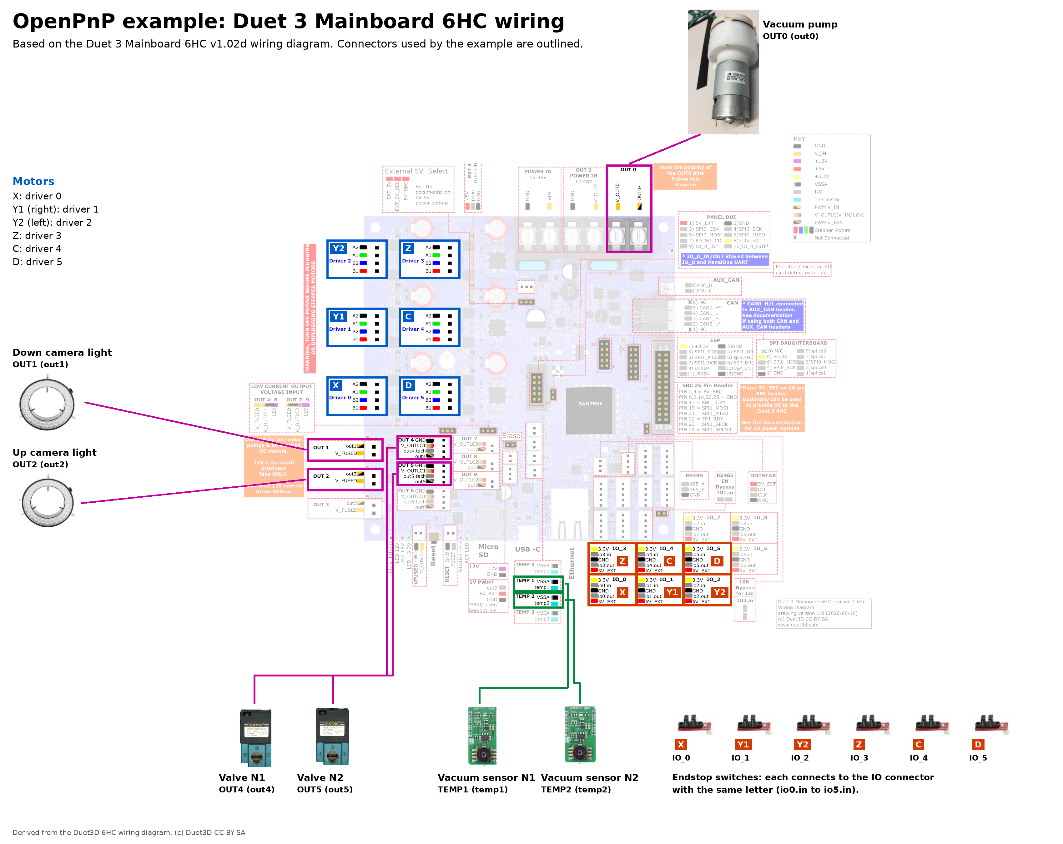

Need to configure the following components.
The X axis to control the movement of the PnP head right and left. Right is positive.
The Y axis to control the movement of the PnP head forward and back. Forward is positive.
The Z axis to control raising and lowering of the PnP nozzle up and down. Up is positive.
The C and D (for dual nozzle) axes rotates clockwise and counter-clockwise. Counter-clockwise is positive.
RepRapFirmware supports X, Y and Z axes as standard and allows you to create additional axes, up to a number that depends on the firmware version and which Duet Mainboard and expansion boards you are using. Axes are created and associated with stepper motors using the M584 command in config.g. You may use any of the following letters to refer to the new axes: U V W A B C D (letter D is not supported in older firmware versions). Lowercase letters are also allowed; see M584.

Actuators are generic devices that perform additional tasks.
; Mosfet outputs
M950 P0 C"out0" ; Vacuum pump output
M950 P1 C"out4" ; Vacuum valve N1 output
M950 P2 C"out5" ; Vacuum valve N2 output
M950 P5 C"out1" ; Down camera lights output
M950 P6 C"out2" ; Up camera lights output
Some machines control the vacuum in the head to confirm the pick of a component, for this we use vacuum sensors like MPXV6115V.
; Sensors
M308 S1 P"temp1" Y"linear-analog" A"V_Sen_H1" F1 B0 C4095
M308 S2 P"temp2" Y"linear-analog" A"V_Sen_H2" F1 B0 C4095
