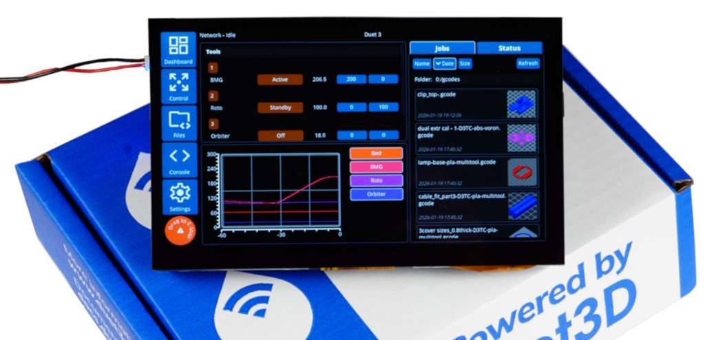

The Duet3D DuetScreen is a family of colour touch screen controllers for Duet 2 and Duet 3 based machines. It is also compatible with other controllers running RepRapFirmware.
The current hardware implementation is the DuetScreen 7. Other screen sizes are planned in the future.
The DuetScreen application is built on LVGL and provides a modern machine control UI, initially focused on 3D printers. Its modular design allows for future versions for other machine types.

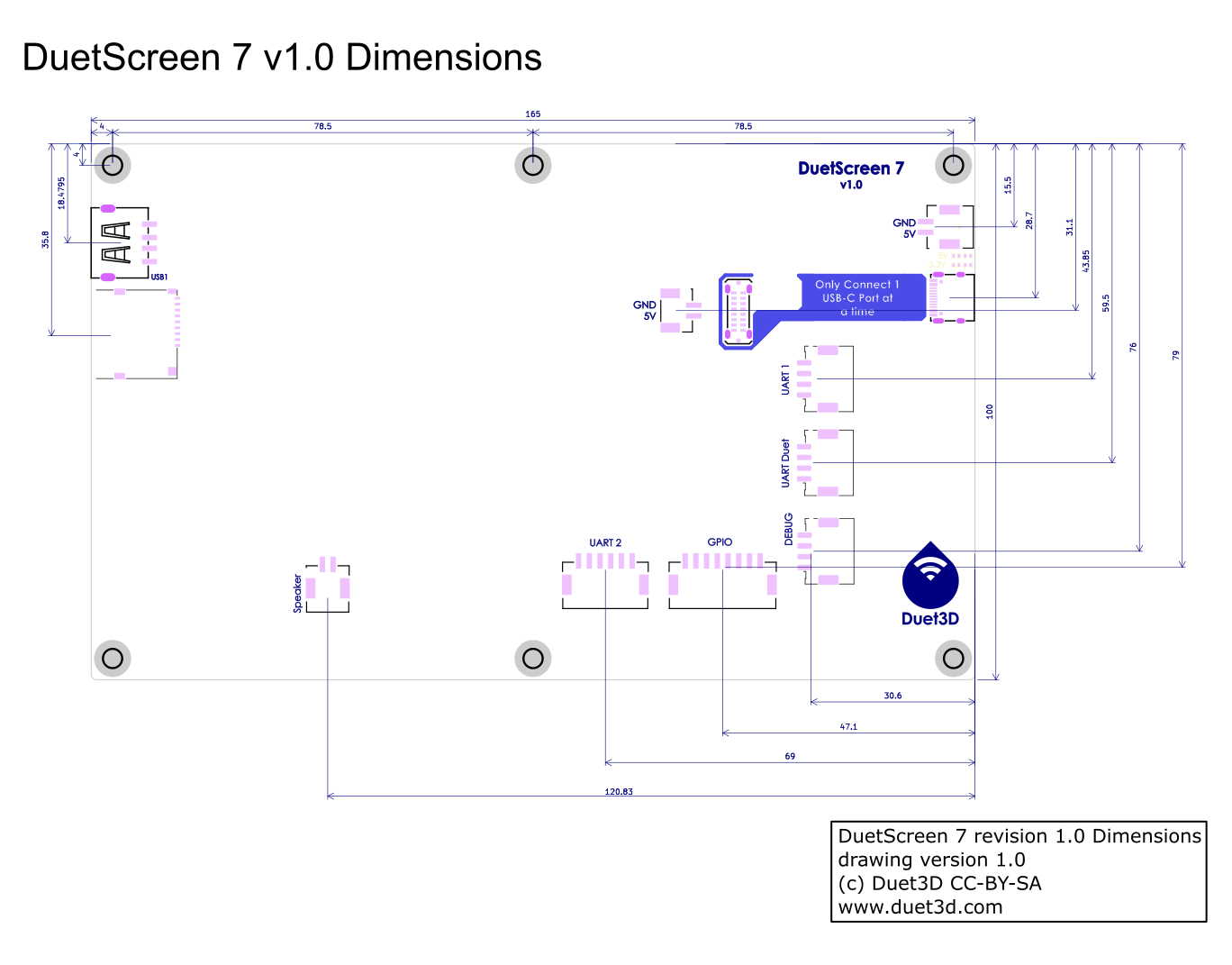

The DuetScreen 7 has 6 mounting posts. These are M3 tapped, 8mm high posts soldered into the board. In many cases only the outer 4 will be required.
Do not over torque screws into these mounting posts. They are rated to 0.5 Nm. However, to mount the screen there is no need to go above 0.2 Nm.
A zip of the STEP file for the screen is here: duet_screen_7_1.0_step.zip

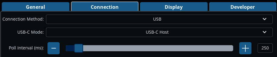

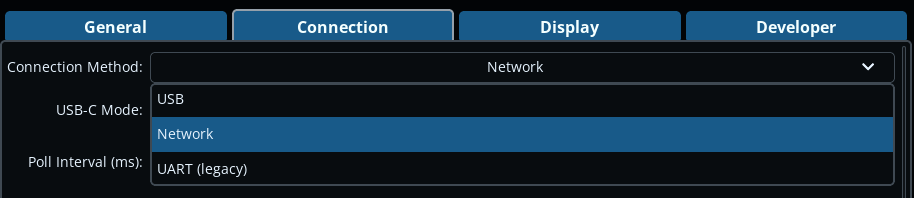

Multiple methods are available to connect the DuetScreen to a mainboard. The recommended method is to use a USB cable. This allows for a consistent connection, not reliant on a WiFi network and is the easiest to set up.
The Connection choice is made on the Settings > Connection screen:
USB-C Host.
When the DuetScreen detects a USB connection to a Duet3D mainboard, it will automatically send
M575 P0 S4to configure the mainboard for USB communication.

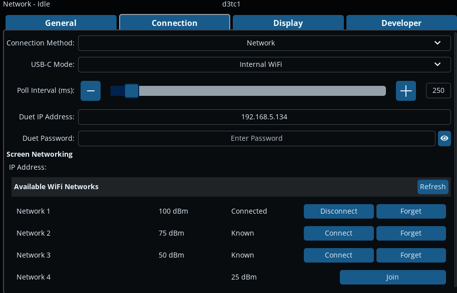

There are a couple of methods to connect the DuetScreen to a WiFi network.
You can connect to a network using the Settings > Connections page in the GUI. This method is useful if you are setting up a single DuetScreen and you do not know the WiFi credentials in advance.
Refresh. You may need to restart the DuetScreen if you have recently enabled the WiFi module.Join button, and enter the SSID passwordDisconnect and ForgetDisconnect and then Connect to another SSIDForget, the SSID will be removed from the list of remembered SSIDsYou can copy a file called wpa_supplicant.conf to the root of the microSD card. This file should be placed on the microSD card after it has been flashed. This method is the easiest if you are setting up multiple DuetScreens, or you know the WiFi credentials in advance. This file should contain the WiFi credentials in the following format:

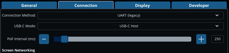

This method is for legacy support only to provide an easy upgrade path for PanelDue users. It is not recommended for new installations.
UART (legacy).115200. Use M575 P2 S4 B115200 in config.g (in RRF 3.6, use M575 P1 S4 B115200). This is similar to connecting a PanelDue, other than the default baud rate is 115200For a Duet3 IO0 port for UART is as follows:
| Duet3 Mainboard - IO0 Connector | DuetScreen - UART Duet connector |
| 5V | 5V |
| io0.out | U5-R |
| GND | GND |
| io0.in | U5-T |

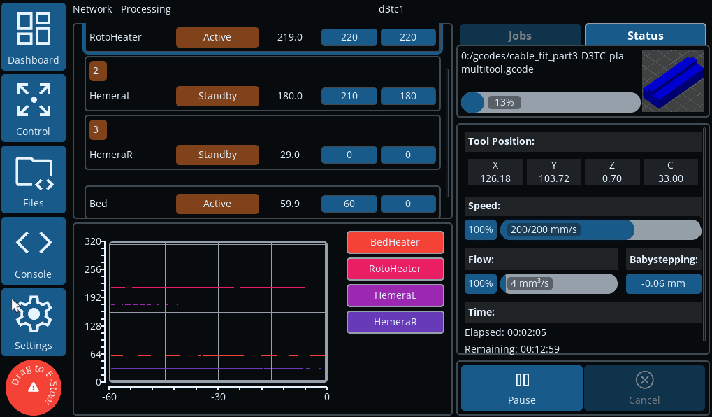

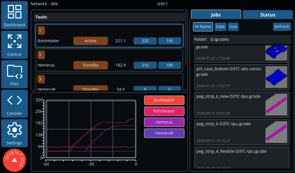

The Dashboard screen gives you a quick overview of the state of your machine.
Tools, heaters and temperatures are displayed on the left. The currently-active tool, if any, will be highlighted. Tools can be set to active or standby, and heaters can be set to active, standby or off. Active and standby temperatures can be set. Tools, beds and chamber heaters are all displayed. Drag up and down to see the full list.
Heater temperatures are shown on the graph. Heaters can be individually turned off and on by clicking their name next to the graph.
On the right side of the Dashboard screen, there are two tabs.
The Jobs tab shows the list of jobs in the /gcodes folder on the SD card, including sub-folders. The list can be ordered by Name, Date or Size.
Note: job thumbnails will only show once you have clicked on the job to show the detail view (see below). Then the thumbnail will show in the Jobs list.
Clicking on a job opens a window with more information on the job and the thumbnail (if available), with options to print or return to the file list.

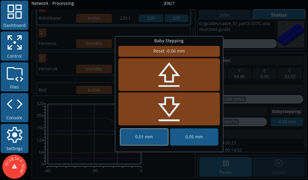

The Status tab shows the progress of the current job, if one is running. It reports the current tool position at all times. Speed factor, extrusion factor and babystepping controls can be quickly accessed here.

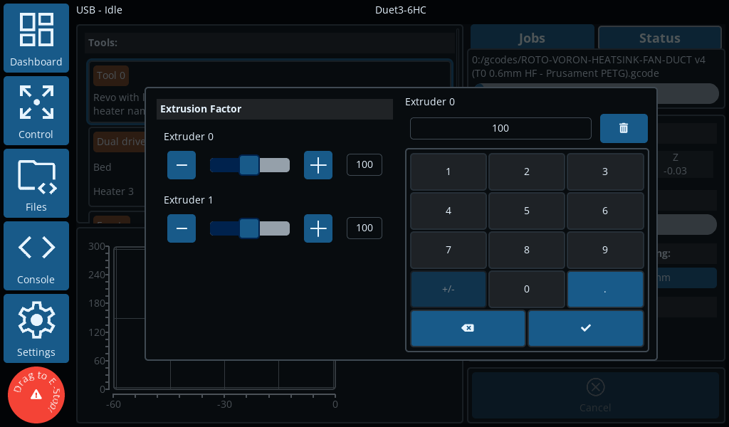

Note: changing values in these dialogue boxes takes effect immediately, not when the dialogue box is closed.
Tapping on the Speed percentage brings up the Speed Factor dialogue box. Adjust the speed factor as necessary.
Tapping on the Flow percentage brings up the Extrusion Factor dialogue box. Adjust the Extrusion factor as necessary.
Tapping on the Babystepping setting brings up the Babystepping dialogue box. Adjust babystepping as necessary.

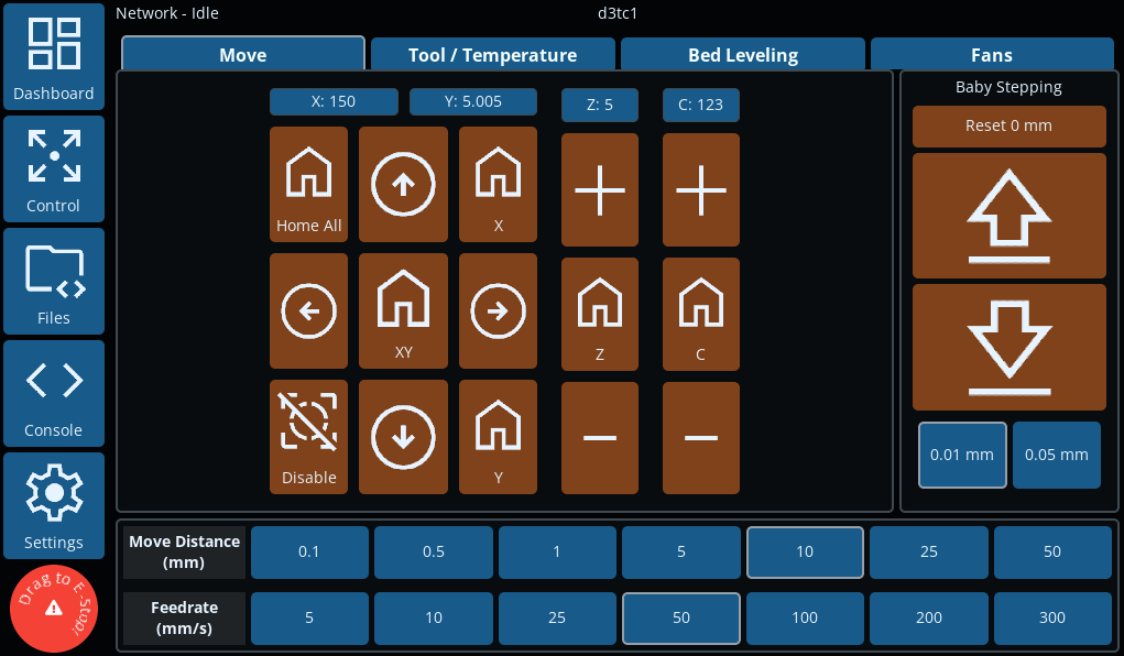

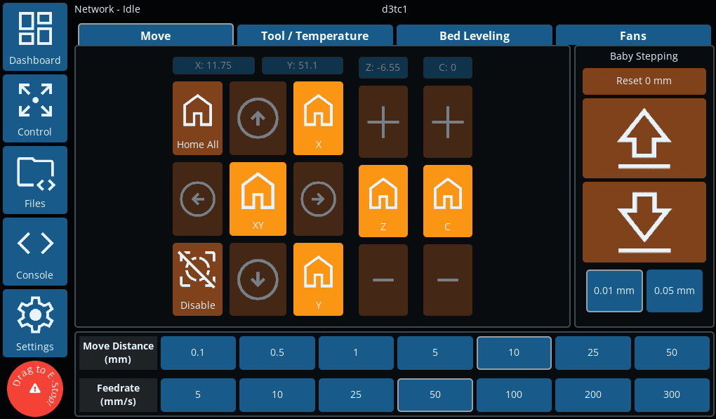

The Control screens give you more fine-grained, manual control over your machine.
The initial Move tab gives you control over the axes, typically showing the X, Y and Z axes. Additional axes will show next to the Z axis.
There are buttons for homing all axes, individual axes, and disabling motors (M18). These all have confirmation dialogues, to avoid unexpected movement if you press them by mistake.
If axes are unhomed, the homing buttons will be brighter, and the move buttons can not be used.
Once homed, axes can be moved using the arrow buttons, or +/- buttons. Distance and Feedrate are set at the bottom of the screen.
Babystepping can be adjusted using the controls on the right side.

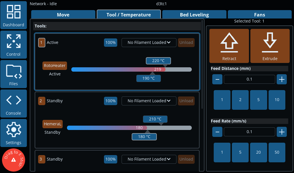

The Tool / Temperature tab gives granular control over tool states.
The currently-active tool, if any, will be highlighted. Tools can be set to active or standby, and heaters can be set to active, standby or off. Active and standby temperatures, and extrusion factor can be set. Filaments can be set, loaded and unloaded.
On the right is the extrusion control for the current tool. Set the distance and feedrate, then use the Retract and Extrude buttons to move the filament.

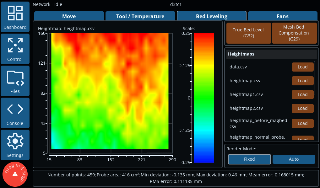

The Bed Levelling tab presents controls for True Bed Levelling (G32) and Mesh Bed Compensation (G29). Previously saved bed meshes can also be viewed and loaded.

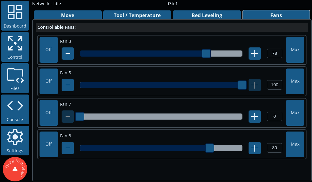

The Fans tab shows currently configured fans, and allows manual control over them. Fan percentage can be set by clicking the "Off" or "Max" buttons, using the +/- buttons to increase/decrease the percentage, or by clicking on the fan percentage and using the fan dialogue to enter the amount.

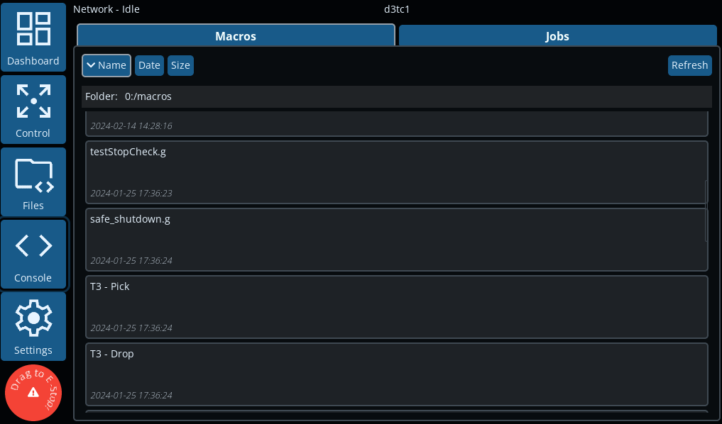

The Files screen has two tabs, allowing access to files that have been uploaded to the SD card.
The Macros tab shows the list of macros in the /macros folder on the SD card, including sub-folders. The list can be ordered by Name, Date or Size. Selecting a macro will give you the option of running the macro, or cancelling.

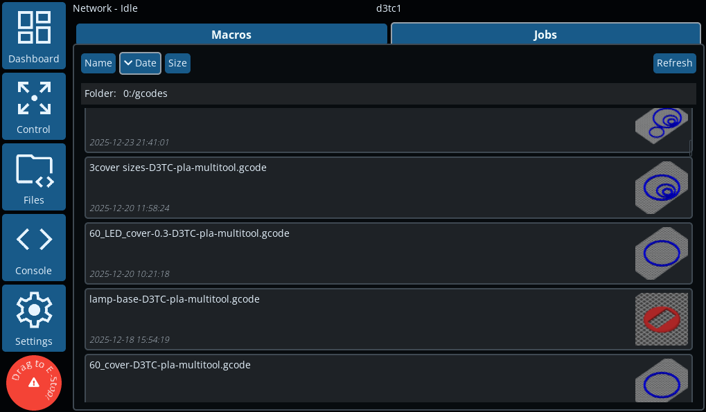

The Jobs tab shows the list of jobs in the /gcodes folder on the SD card, including sub-folders, with any . The list can be ordered by Name, Date or Size.

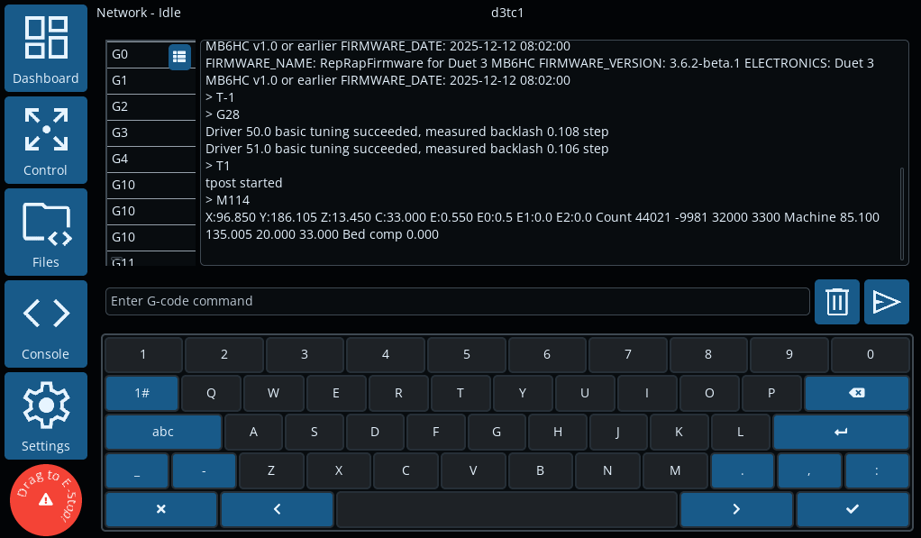

The Console screen provides a serial terminal for sending GCode commands directly to the Duet. There is also a GCode command glossary, with brief descriptions of all GCodes.

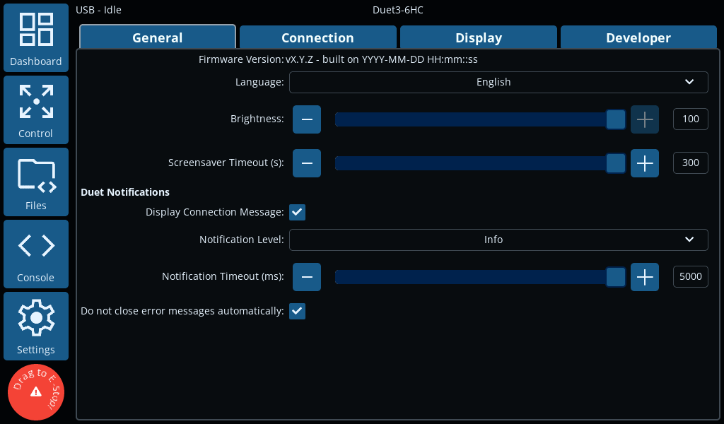

The Settings screens allow you to manage and fine tune the DuetScreen for your machine. There are four tabs.
The General tab has settings for initial DuetScreen setup, and message notification handling.
The Notification Level changes what severity of messages are displayed as a modal. Messages are typically responses to gcodes (a failed G28 would generate an error for example). The messages are categorised into a severity like DWC and only messages that have an equal or greater severity to the setting you choose will be shown as a modal. There are 4 levels to the notifications: Info, Success, Warn and Error. Info will show all messages, Warning is only warning and errors, and Error is only errors.
This doesn't impact what is displayed in the console, as all messages are shown there.
The Connection tab configures which port to use to connect to the Duet mainboard (USB, WiFi or UART).
If WiFi is selected, it will search for WiFi SSIDs and show a list to connect to. The DuetScreen keeps a list of remembered WiFi SSIDs for easy connection. Once connected, enter the Duet IP address and password (if necessary) to connect.

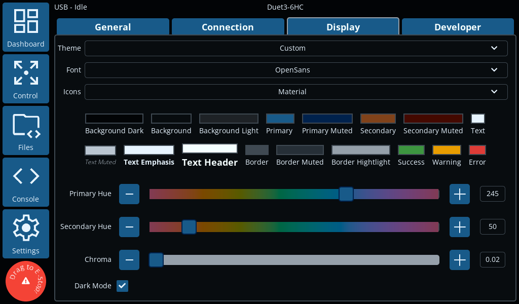

The Display tab provides options for customising the display. There are a number of different themes, and options for changing the fonts and the icon set.
Using the "Custom" theme, you can also change the primary and secondary colour palette.
