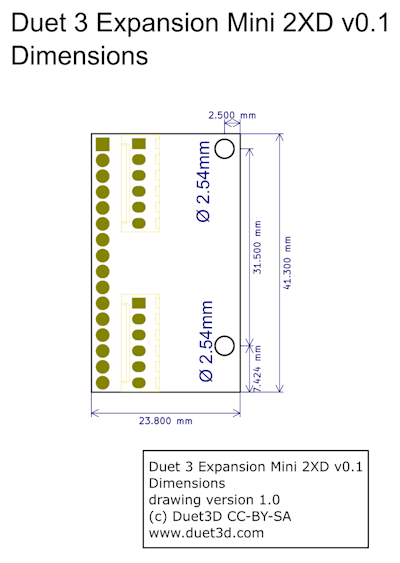

The Duet 3 Expansion Mini 2XD has mounting standoff holes that align with matching holes on the Duet 3 Mini 5+.
These pictures show the Mini 2+ mounted but the procedure is the same of the Mini 2XD
Nylon standoffs are supplied with the Duet 3 Expansion Mini 2XD to mount it securely.

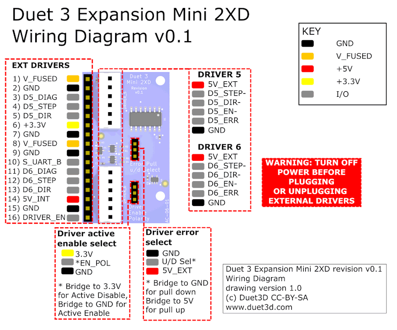

The Duet 3 Expansion Mini 2XD supports directly connecting external stepper drivers that have opto-isolated or similar inputs. Note that:
M569 R# parameter overrides the jumper.This diagram shows connection to a typical optoisolated stepper motor driver, it is the same as on the 6XD.
For firmware configuration, including mapping drives to axes, configuring enable polarity, and configuring step timing, see the Connecting external stepper and servo drivers wiki page.
