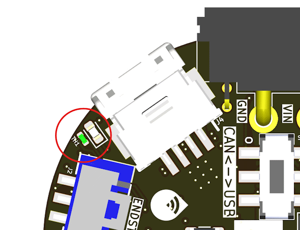

This helps monitor chamber and INDX MCU board temperature.
M308 S11 Y"board-temp" P"121.dummy" A"INDXboardtemp" ; Onboard INDX board sensor
The location of the thermistor is shown here:
It is not immune from self heating on the INDX PCB, so it is not an absolute measure of the chamber temperature, but is a useful data point about the temperature of INDX mcu board which is useful, especially if running INDX in a heated chamber close to the design limits set by Bondtech.

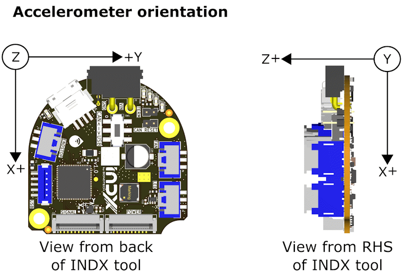

Add the following to your config.g:
M955 P0 C"121.i2c.lis" I16 ; Configure INDX accelerometer
See M955 for how to set up and configure the accelerometer.
In the normal INDX mounting orientation, with tools picked up from the front Z+ of the accelerometer is +Y on the machine, and +X is oriented to -Z. So the correct command is
If you have tools mounted on the rear instead and the INDX head mounted backwards, then Z+ of the accelerometer is -Y, and +X is oriented to -Z. so the correct command is
M955 P0 C"121.i2c.lis" I56
For an overview of using accelerometers to capture data on axis movement see: Connecting an accelerometer
