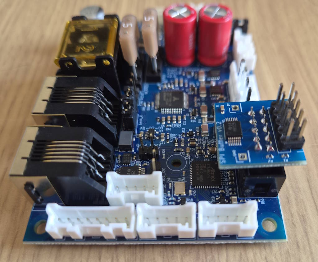

V2.0 Magnetic Encoder boards are supplied with an SPI buffer board, see here mounted on the 1HCL box header
The v2.0 magnetic encoders have a buffer on SPI_MISO, and expect 5V signals on MOSI_SCK and CS lines. The buffer board provides this and drops the MISO signal back to 3.3V.
The SPI Buffer board MUST be used with v2.0 Magnetic encoders. It MUST NOT be used with v1.0 Magnetic encoders.

Connect the encoder board to the Duet 3 Expansion 1HCL to the Magnetic Encoder v2.0 Buffer board using a 10-way straight-through ribbon cable. Fit the buffer board into the 10-way box connector on the 1HCL.
Ensure that the SPI buffer board is placed centrally in the socket on the 1HCL. It is possible to insert it shifted left or right by a pair of pins.
The buffer board must be mounted on the 1HCL box header and not on the Magnetic Encoder board.
As above, but note that the SPI Encoder Input connector on the 1HCL v1.0 is orientated differently from the 1HCL v2.0, and the SPI buffer board should be connected 180° rotated compared to the picture above. See the 1HCL wiring diagrams here.
The above picture shows a 1HCL v1.0 connected to a magnetic encoder v1.0.
