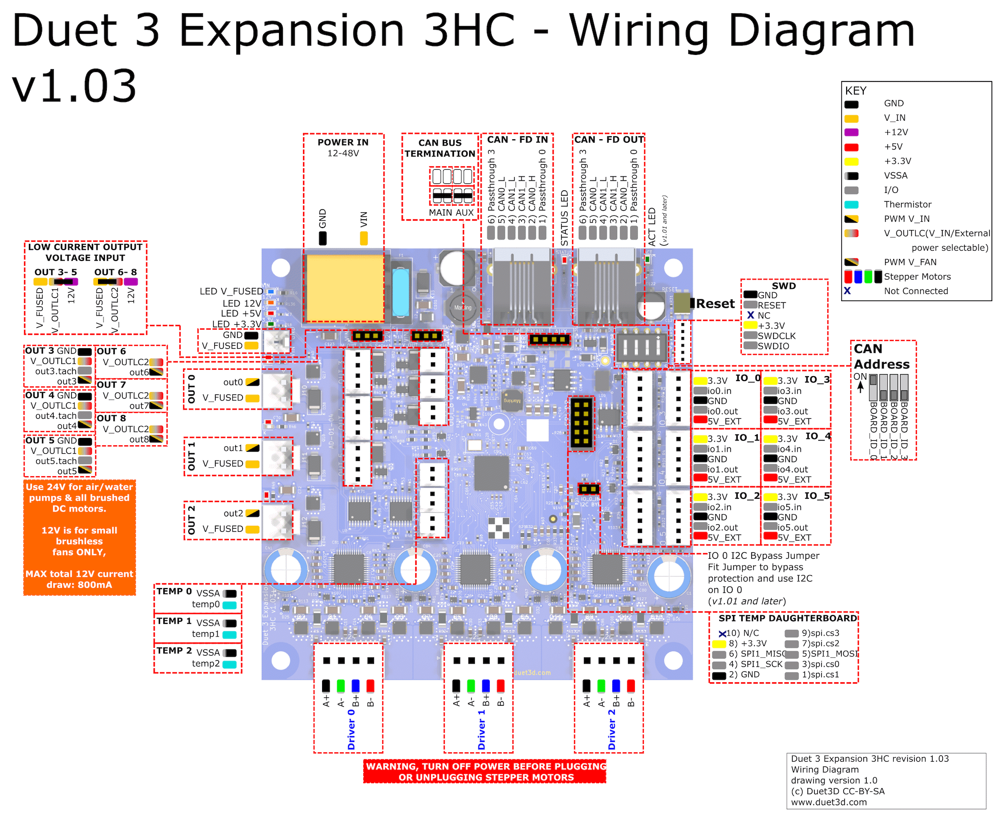

v0.9 prototype wiring is the same as version 1.0 wiring.
Duet 3 Expansion 3HC provides the following connectors:
| Header | Label | Function |
| 1 x 2-way barrier strip | VIN, GND | Two pins for main VIN and GND. VIN power is fused at 10A, individual outputs from the board could add up to >10A (e.g. OUT_0, OUT_1 and OUT_2 are each rated to 6A max) however the total board current should not exceed 10A. |
| 1 x 2-pin KK header | GND V_FUSED | This is for powering an always-on fan or similar. |
| 3 x 2-pin JST VH | OUT_0 OUT_1 OUT_2 | Intended for high current output, eg extruder heaters or fans. Maximum recommended current 6A each. Flyback diodes are built-in to these outputs. (see note on JST VH connectors below) |
| 3 x 4-pin KK headers with offset spigot | OUT_3 OUT_4 OUT_5 | These are intended for PWM-controllable fans although they can be used for other purposes. Maximum recommended current 2.5A each. The connector fits a standard PC-type 4-pin PWM fan. Alternatively, a 2-pin fan may be connected between the V_OUTLC1 pin (+ve) and the OUT_[n]_NEG pin (-ve). |
| Note: OUT_3, OUT_4 and OUT_5 are protected by a flyback diode connected to V_OUT_LC_1. Do not mix loads connected to V_OUT_LC_1 with the jumper set to 12V and loads connected to V_FUSED on the same bank. | ||
| 1 x 3-pin KK header | OUT_3,4,5 Select V | The positive supply to the OUT_3, OUT_4, and OUT_5 connectors is the centre pin of the 3-pin jumper block. A jumper selects between powering them from the fused VIN supply or the internal 12V regulator. Alternatively you can connect a 3-terminal buck regulator to the 3-pin jumper block to supply the required voltage to the centre pin. |
| Max 12V current :The two banks of Low Current outputs (OUT_3-5, OUT_6-8) can be separately selected to be powered by either VIN or internal 12V. Total 12V fan current draw must not exceed 800mA. | ||
| 3 x 2-pin KK headers | OUT_6 OUT_7 OUT_8 | These are intended for fans. Maximum recommended current 2.5A each. Flyback diodes are built-in to these outputs. |
| Note: OUT_6, OUT_7 and OUT_8 are protected by a flyback diode connected to V_OUT_LC_2. Do not mix loads connected to V_OUT_LC_1 with the jumper set to 12V and loads connected to V_FUSED on the same bank. | ||
| 1 x 3-pin KK header | OUT_6,7,8 Select V | The positive supply to these connectors is the centre pin of the 3-pin jumper block. A jumper selects between powering them from the fused VIN supply or the internal 12V regulator. |
| Max 12V current :The two banks of Low Current outputs (OUT3-5, OUT6-8) can be separately selected to be powered by either VIN or internal 12V. Total 12V fan current draw must not exceed 800mA. | ||
| 3 x 2-pin KK headers | TEMP_0 TEMP_1 TEMP_2 | Connections for thermistor or PT1000 sensors. |
| 1 x 2x5 header | This is for connecting PT100 and thermocouple interface boards (the same boards that the Duet 2 series uses). | |
| 3 x 4-pin JST VH | DRIVER_0 DRIVER_1 DRIVER_2 | Stepper motor connections. (see note on JST VH connectors) |
| 1 x 2x5 header | SPI_1 / TEMPDB | This is for connecting PT100 and thermocouple interface boards. In RRF 3.7 and later, an SPI accelerometer can also be connected. |
| 6 x 5-pin KK headers | IO_0 IO_1 IO_2 IO_3 IO_4 IO_5 | These are for endstop switches, Z probes, filament monitors, servos, and other low-voltage I/O functions. Each connector provides both 3.3V and 5V power. The inputs will tolerate up to 30V. The outputs are 3.3V signals levels with 470R series resistors. |
| Caution! Check the pinout of these using the wiring diagram linked above before connecting anything to them. | ||
| 1 x 6-pin SWD connector | SWD | This is for firmware debugging and also provides a backup mechanism to program firmware. |
| 1 x 4-way DIP switch | CAN ADDR | Used for setting the CAN address. See CAN section below. |
| Reset | Single push to reset the board. | |
| 2 x RJ11 CAN connectors | CAN_IN CAN_OUT | RJ11 CAN connectors. See CAN section below. |
| 1 x 4-pin jumper header | TERM_R | CAN bus termination. See CAN section below. |

There are 6 IO headers on board. Each has an input and output along with 3.3V, 5V and Gnd supplied. This enables them to support a wide range of endstops, probes, filament monitors and future low bandwidth devices.
RepRapFirmware 3 can be configured to map these ports to the appropriate functions as required.
Except as noted in the table below, an IO_x_IN pin can always be used to provide a digital input (e.g. for endstop inputs or filament monitors), and an IO_x_OUT pin can always be used to provide a digital output. On the version 0.6 and 1.0 boards the individual IO_x connectors have the following additional capabilities:
| IO # | UART/I2C? | Analog in? | PWM out? | Notes |
| 0 | yes1 | yes | no | Can be used with I2C from v1.01 onwards 2 |
| 1 | yes1 | yes | yes | |
| 2 | yes1 | yes | no | |
| 3 | no | no | no | |
| 4 | no | no | yes | |
| 5 | no | yes | no |
1 RepRapFirmware does not currently support UART or I2C on Duet 3 expansion/tool boards.
2 To use IO 0 with I2C the protection bypass resistor must be fitted to bypass the 10K series resistor. If this is fitted then IO0.in is no longer protected sufficiently against over voltage/over current. Note that RepRapFirmware does not currently support I2C on Duet 3 expansion boards.
VIN in the range 12V-48V (12V-32V v1.01 and earlier) must be provided to the Duet expansion board. The board produces onboard 12V, 5V and 3.3V, from VIN (12V will not be produced if only 12V is provided as VIN).
These voltages are divided for internal and external use, with external 3.3V and 5V going to IO and other headers, and external 12V if provided to the low current fan voltage selection pins.
Max 12V current: The two banks of Low Current outputs (OUT3-5, OUT6-8) can be separately selected to be powered by either VIN or internal 12V. Total 12V fan current draw must not exceed 800mA.
Max 5V and 3.3V current: Up to 800mA from 3.3V and 5V combined, of which no more than 500mA from 3.3V.

Two RJ11 connectors labeled CAN IN and CAN OUT. It doesn't matter which you use for the cable from the main board and which you use for the cable to the next expansion board, because they are wired in parallel.
The DIAG LED between the two CAN connectors indicates CAN bus state. When the expansion board starts up this LED will blink rapidly. If the expansion board is connected to a main board running compatible firmware, the LED on the expansion board will switch to blinking synchronously with the main board LED once time sync has been established across the CAN bus.
From V1.03 there are two CAN buses on the connector CAN1 (pin 3 and 4) is the primary CAN-FD bus and is used for normal Duet 3 expansion operation, CAN0 (pins 2 and5) is a secondary CAN bus for future firmware use.
Just behind the RJ11 connectors is a 4-pin terminal block. termination is required on the last board in the CAN chain only (the one with a cable in only one of the RJ11 connectors). Jumpers must not be fitted in expansion boards that are not at the end of the CAN bus.
Two jumpers must be fitted in that block to terminate the CAN bus.
A jumper must be fitted in the MAIN position to terminate the CAN1 main bus. Similarly a jumper must be fitted to the AUX position to terminate the CAN0 aux bus.
