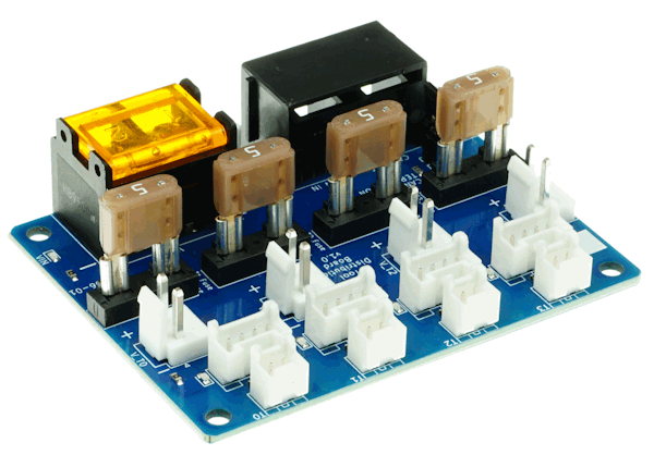

The Duet 3 Tool Distribution Board v1.0 is supplied with:
The Duet 3 Tool Distribution Board v0.5 is supplied with:

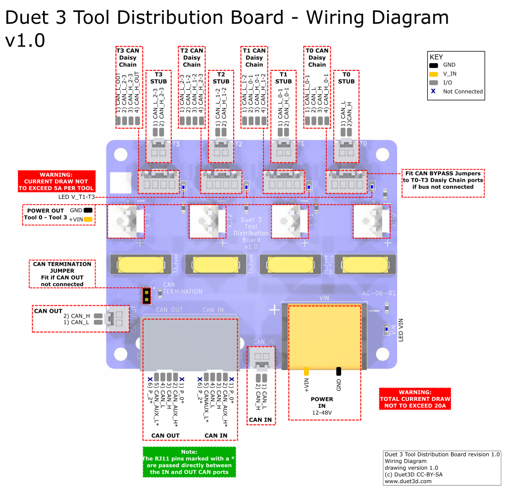

Input power voltage | 12V to 32V |
Power input connector rated current | 20A maximum, or fused limit (whichever is lower) |
Power output connector rated current | 5A for each tool power output |
Fuses | 4x 5A fuses for each tool power output |
Maximum ambient temperature | 70°C |
Supply between 12V and 48V to the 2-way barrier strip power connector on the board, observing the correct polarity.
Use the four 2-way JST VH connectors for power out to tool boards. Each output is individually fused, with a supplied 5A fuse.
If you use a relay to control VIN power to the board, ie the power supply is already switched on, and a relay is used to turn on power to the board, you should use an inrush current limiter wired in series with VIN. See the section on Inrush current here.
OUT ports on the mainboard should NOT be used to switch power to expansion or tool boards directly. See the note at the end of the 'inrush current' section at the link above.

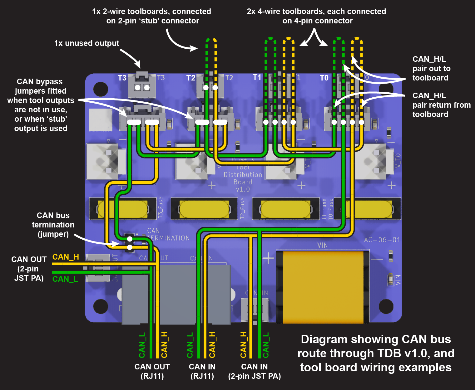

The Tool Distribution Board provides flexibility in extending the CAN bus, offering a number of different ways to connect a range of two- and four-wire CAN bus expansion and tool boards.
The Tool Distribution Board does this by extending the CAN bus internally.
Tool Distribution Board supplies convenient places to connect either a loop in the CAN bus (4-wire connection) or a stub (2-wire connection). The type of connection can be mixed as necessary, so long as the continuity of the CAN bus is preserved. Connect expansion and tool boards by:
Expansion and tool boards that have a two pairs of CAN pins, or two RJ11 ports, can be connected as a loop in the CAN bus. This includes the Duet 3 1LC, 3HC, 1XD, 1HCL and M23CL.
Originally, the Tool Distribution Board was developed to provide an easy way to connect Duet 3 Toolboard 1LC boards. The supplied cables connect directly to that board, but can be adapted to connect other 4-wire boards. To connect:
As the Tool Distribution Board is just providing a convenient place to connect a loop in the CAN bus, multiple boards can be connected in each loop from the board.
Boards with a 2-pin only connection, eg Duet 3 Roto toolboard, Scanning Z Probe, and mainboards when used as an expansion board, can use a 4-wire connection, by wiring a loop of CAN wires, and having a short 'stub' of a pair of wires off the loop, connected to the board.
(Picture to come)
Some expansion and tool boards only have a two-pin CAN connection, eg Duet 3 Roto toolboard, Scanning Z Probe, and mainboards when used as an expansion board. This necessitates a two-wire connection. Though actually all expansion, tool, and mainboards-as-expansion boards can be connected using just two CAN wires. This is like a branch off the main CAN bus, and is called a 'stub'. There are some rules to stubs:
To connect a stub to the Tool Distribution Board:
Stubs can support more than one board, so long as the total length of the stub is under 1m.
If no expansion or tool board is to be connected to a tool connector, leave the CAN bypass jumpers in place. This allows the CAN bus to continue on to the next tool connector, to the termination jumper, or the CAN OUT RJ11 connector.
CAN bus termination is required at each end of the CAN bus. The mainboard, usually at one end, supplies the termination there. So long as the continuity of the bus is maintained through the Tool Distribution Board (ie with bypass jumpers or wiring tool/expansion board with a 4-wire connection), the CAN bus can be terminated on the Tool Distribution Board.
Alternatively, you can put the termination on the last toolboard on the Tool Distribution Board.
If there are further CAN expansion boards connected via the RJ11 CAN OUT connector, remove the termination jumper from the Tool Distribution Board.
