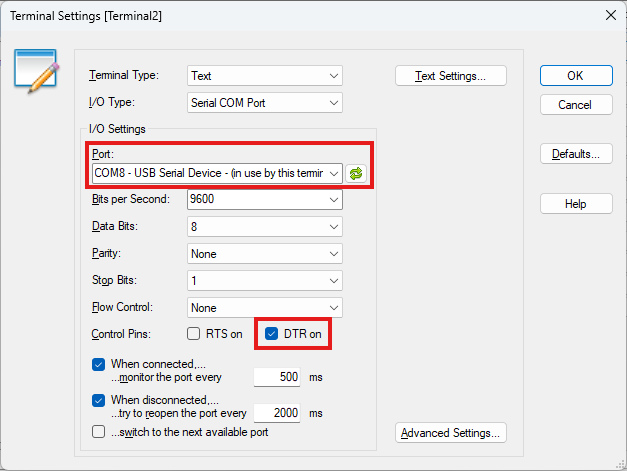

If the "Terminal Settings" screen doesn't open automatically, select "Terminal" menu, then "Settings".
Select the correct COM port as the Serial Port.
If unsure of the COM port number, press Windows Key + R on your keyboard and type devmgmt.msc. Your Duet will be listed under Ports (COM & LPT) as USB Serial Device (COM#) or similar. Use COM# as the Serial Port in YAT.
Select "DTR on"
For newer versions of RepRapFirmware (3.6 and later), on Duet 3 boards, the terminal emulator must raise the DTR line, otherwise RRF will not transmit data.
Older versions of YAT don't have this option, but DTR can be enabled on the connection screen. For older versions of RRF, it doesn't matter if this is enabled or disabled.
The rest of the default values, eg for Bits per second etc, should work.

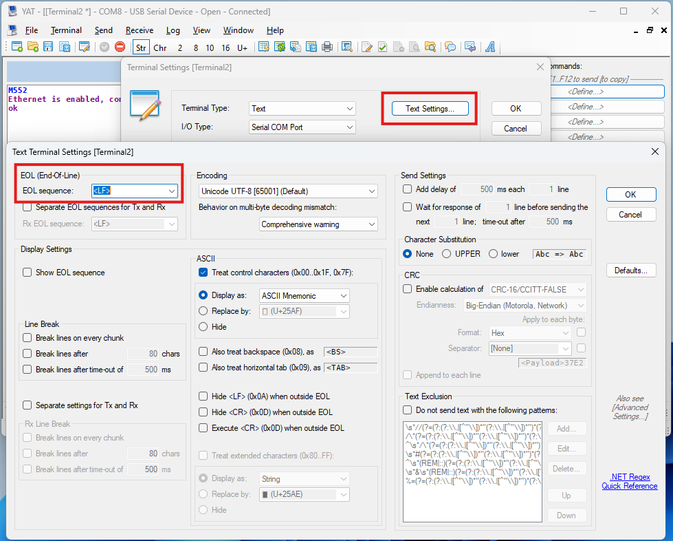

Set YAT to use <LF> as the end of line character
This will improve the readability of the messages coming from the Duet. Click "Text Settings" in the "Terminal Settings" and change "EOL sequence:" to <LF>. Click "OK" to close Text Settings. Click "OK" again to close Terminal Settings.

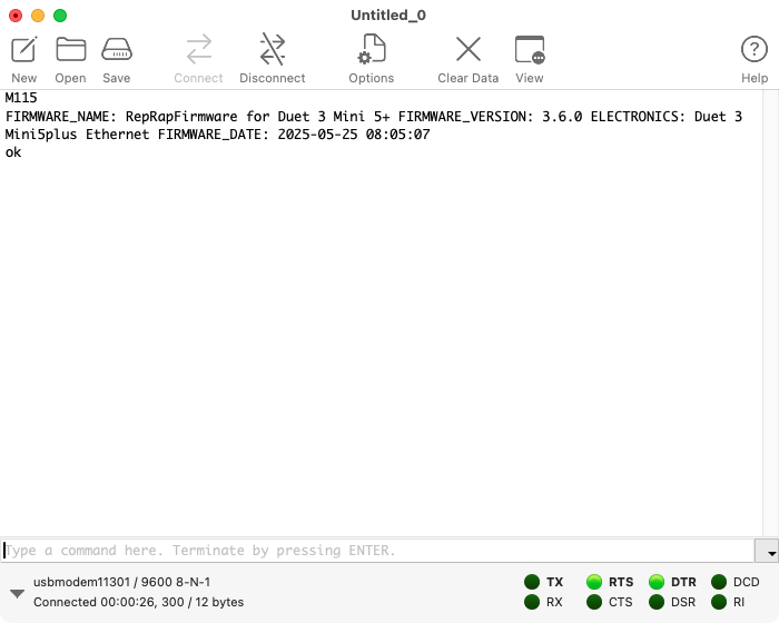

We recommend using CoolTerm from https://freeware.the-meiers.org/.
Go to Options > Serial Port and select the Duet from the 'Port:' drop down menu; it will be named something like "usbmodem1411". Baud rate can be set to 115200.
Go to Options > Terminal > 'Line mode', which sends your command line when you press return rather than character by character ('raw mode'), and turn on 'Local Echo' so it shows the command you have sent.
Click 'OK' to save the options, then click 'Connect'. For newer versions of RepRapFirmware (3.6 and later), on Duet 3 boards, the terminal emulator must raise the DTR line, otherwise RRF will not transmit data. CoolTerm should enable this automatically; check that the radio button next to 'DTR' is green, and click it if it is not. For older versions of RRF, it doesn't matter if this is enabled or disabled.

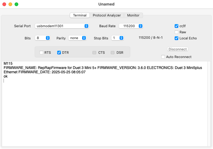

If you prefer to use an app from the Appstore, try SerialTools.
Install SerialTools and run it. Select the Duet from the 'Serial Port' drop down; it will be named something like "usbmodem1411". Baud rate should be 115200, and Local Echo should be ticked. Click 'Connect' to connect.
For newer versions of RepRapFirmware (3.6 and later), on Duet 3 boards, the terminal emulator must raise the DTR line, otherwise RRF will not transmit data. Click the checkbox next to "DTR". For older versions of RRF, it doesn't matter if this is enabled or disabled.
SerialTools is a bit finicky about text input; you have to get the Gcode command correct, without pressing delete or cursor keys. It sends each character to the Duet as you type them (raw mode), rather than when you press return. If you navigate away from SerialTools to another application, and then back, in the middle of writing the command, the command won't work. You should get an 'ok' when a command goes through correctly.

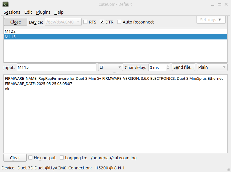

There are many options to connect using Linux. Our favourite is to use CuteCom, which is a GUI serial terminal.
It's available in most package repositories, or install with sudo apt install cutecom. It should automatically detect the correct port (usually /dev/ttyACM0), and is configured correctly out of the box. Click 'Open' to connect.
For newer versions of RepRapFirmware (3.6 and later), on Duet 3 boards, the terminal emulator must raise the DTR line, otherwise RRF will not transmit data. Click the checkbox next to "DTR", or in Settings set 'Flow Control' to 'Hardware'. For older versions of RRF, it doesn't matter if this is enabled or disabled.

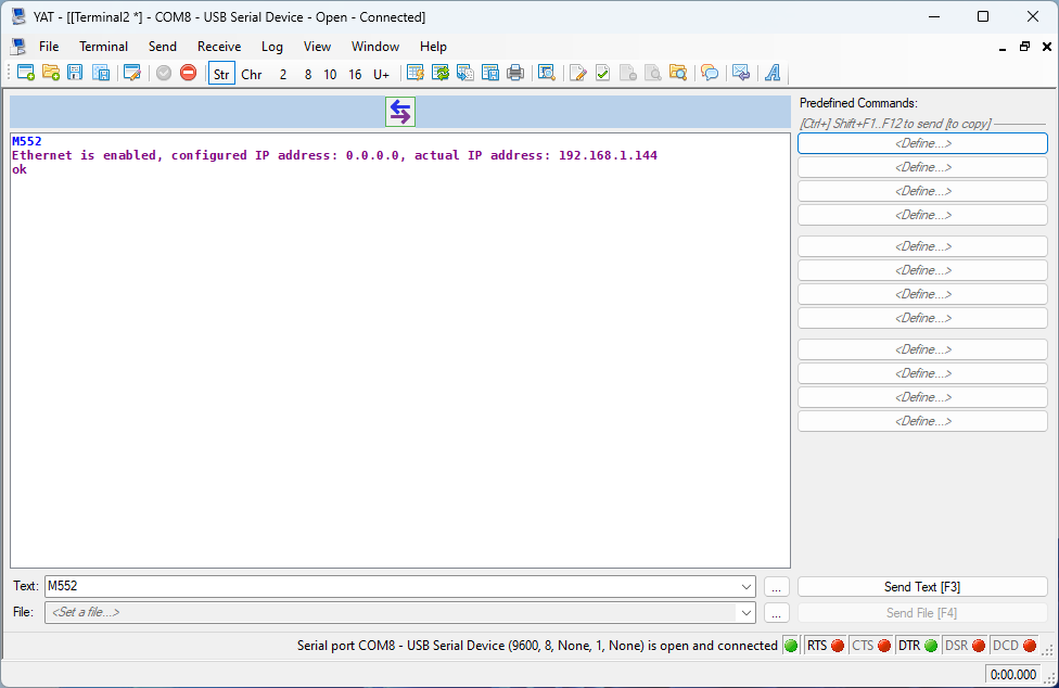

For Duets with Ethernet: Duet 3 Mainboard 6HC, Duet 3 Mini 5+ Ethernet, Duet 2 Ethernet, Duet Maestro.
Send M552 to check the network module status. It may report that the module is disabled or enabled. Put it into disabled mode by sending command M552 S0. Send M552 again to check it is disabled.
Plug an ethernet cable into the Duet's ethernet port and connect the other end of the cable to a free ethernet port on your router/network hub.
The Duet may come with a factory-configured fixed IP address for testing. This is unlikely to work for your setup!
So you need to change the network settings. There are two options:
M552 S0 to disable networking, then M552 S1 P0.0.0.0 to enable networking and have your router assign an IP address.M552 S0 to disable networking, then M552 S1 Px.x.x.x to enable networking, where "x.x.x.x" is the IP address you want to use, eg 192.168.1.15.In both cases, after 10-30 seconds the board should reply with Network running and the IP address the Duet is using. Send M552 to check the settings.
