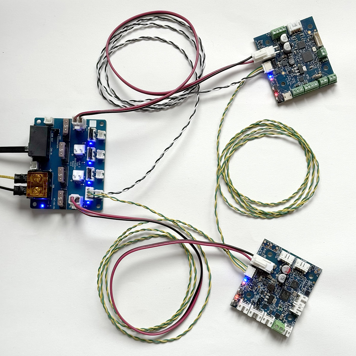

The Tool Distribution Board provides flexibility in extending the CAN bus, offering a number of different ways to connect a range of two- and four-wire CAN bus expansion and tool boards.
The Tool Distribution Board does this by extending the CAN bus internally.
Revision v1.0Revision v0.5
Tool Distribution Board provides convenient places to connect either a loop in the CAN bus (4-wire connection) or a stub (2-wire connection). The type of connection can be mixed as necessary, so long as the continuity of the CAN bus is preserved.
For more information on CAN bus wiring schemes, see CAN connection basics.

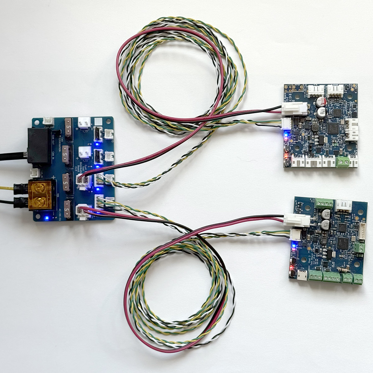

Revision v1.0Revision v0.5Expansion and tool boards that have a two pairs of CAN pins, or two RJ11 ports, can be connected as a loop in the CAN bus. This includes the Duet 3 1LC, 3HC, 1XD, 1HCL and M23CL.
Originally, the Tool Distribution Board was developed to provide an easy way to connect Duet 3 Toolboard 1LC boards. Crimps and housings are supplied to make up cabling (see our wiring guide here). To connect:
- Remove the CAN bypass jumpers from the selected Tool output
- Connect a cable between the Tool Distribution Board and expansion or tool board
- Of the four wires, one pair carries the CAN bus to the tool board, and the other returns from the board, to loop on to the next tool output.
- Make sure CAN_H wires connect to CAN_H pins only, and CAN_L wires connect to CAN_L pins only.
- Up to four expansion or tool boards can be connected.

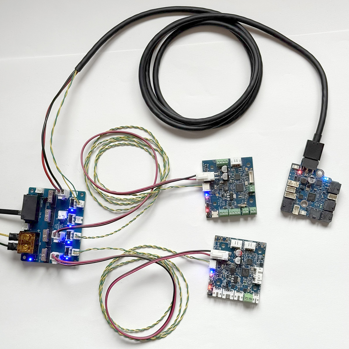

As the Tool Distribution Board is just providing a convenient place to connect a loop in the CAN bus, multiple boards can be connected in each loop from the board.
- Connect a cable between the Tool Distribution Board and multiple boards
- The CAN loop extends from the CAN_OUT pair of pins of the Tool Distribution Board, through each expansion board, and back to the CAN_IN pair of pins.
- This allows for more than one board to be connected per tool connection, and more than four boards in total.

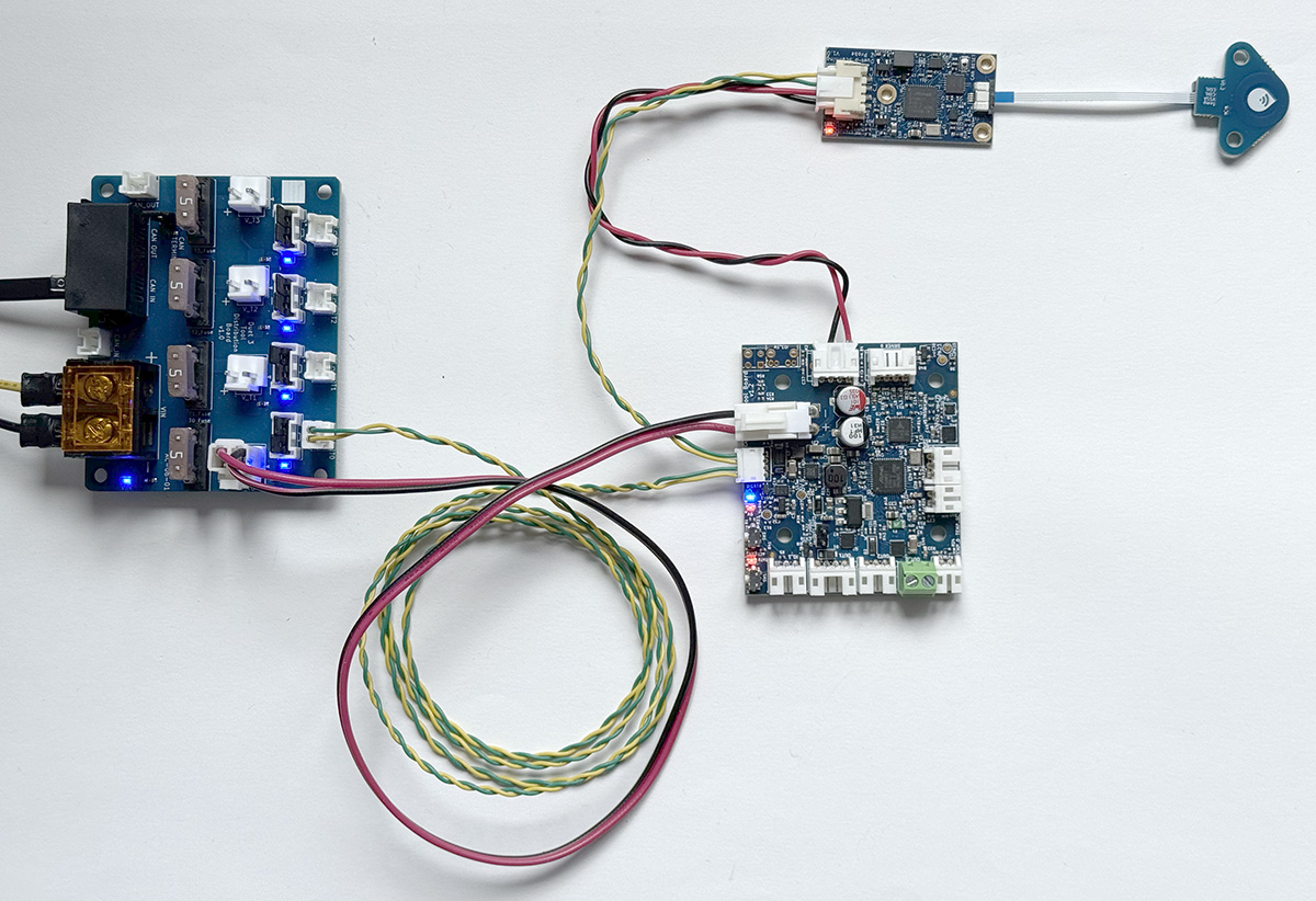

Revision v1.0Revision v0.5Some expansion and tool boards only have a two-pin CAN connection, eg Duet 3 Roto toolboard, Scanning Z Probe, and mainboards when used as an expansion board. This necessitates a two-wire connection. Though actually all expansion, tool, and mainboards-as-expansion boards can be connected using just two CAN wires. This is like a branch off the main CAN bus, and is called a 'stub'. There are some rules to stubs:
- The maximum recommended stub length for the 1Mbit/sec signalling rates used by Duet is 1m, and should preferably use ferrite beads to suppress ringing.
- Stubs can have multiple boards on them, but the total length of the stub should still not be more than 1m.
- The total length of all stubs should not be more than 5m.
- The CAN bus on Duet 3 boards normally runs at 1Mbit/sec by default. If the bit rate is increased using M952, signal reflections caused by stubs will be more significant, making it more important to keep stubs short and/or use ferrite beads.
- Stubs can be mixed with daisy-chaining to create the CAN bus that best suits your requirements.
- Do not terminate the CAN bus at the end of a stub, unless it is the last, or only, stub.
To connect a stub to the Tool Distribution Board:
- Fit both CAN bypass jumpers to the selected Tool output
- Connect a 2-wire cable between the Tool Distribution Board 2-pin CAN output and the expansion or tool board
- The Tool Distribution Boards can support up to four boards directly connected in this way, but make sure the total length of the stubs is less than 5m.
Stubs can support more than one board, so long as the total length of the stub is under 1m.
