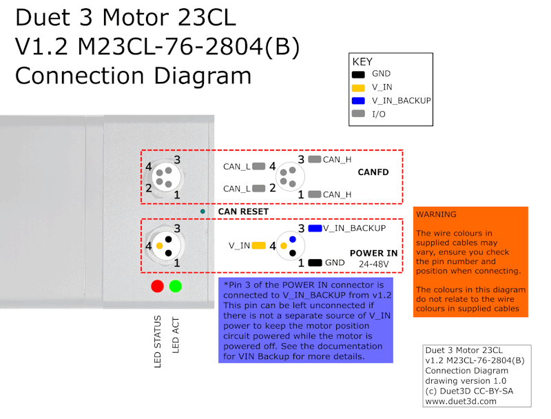

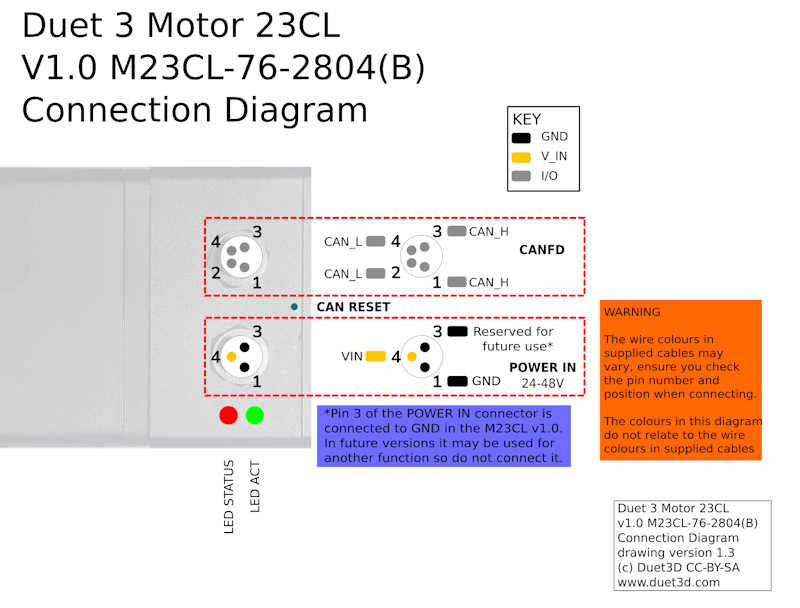

Supply between 24V and 48V to the M8 3-way power connector on the motor, observing the correct polarity.
Do not plug or in the the motors to a power supply that is already plugged in, the inrush current can blow the internal protection fuse.
If you use a relay to control VIN power to the motor, ie the power supply is already switched on, and a relay is used to turn on power to the motor, you should use an inrush current limiter wired in series with VIN. See the section on Inrush current here.
OUT ports on the mainboard should NOT be used to switch power to expansion boards, tool boards or CAN-connected motors directly. See the note at the end of the 'inrush current' section at the link above.
Pin 3 of the POWER in connector in version v1.0 of the Duet 3 Motor23CL is internally connected GND. From v1.1 it is connected to a separately fused V_IN_BACKUP circuit that just keeps the logic elements of the control board running, but not motor power, if V_IN power is removed. this allows a safety system to interrupt motor power, without the motor loosing encoder position.
When VIN power to the motor is reapplied by the safety relay an inrush of current will occur, you should use an inrush current limiter wired in series with VIN. See the section on Inrush current here.
In version 3.6 and 3.7 firmware when V_IN power is applied, the motor will attempt to move back to the position its commanded to be in as rapidly as it can. If the motor was moved while VIN power was not applied then this can cause undesirable results. This behaviour may be addressed in future firmware versions, until that time avoid moving the motor when in this state, alternatively if that's not possible (e.g. due to a Z axis that moves under load when not powered), use a Motor 23CL with a brake.
The M23CL has two pairs of CAN_L and CAN_H connectors on a M8 4-way connector, one each for the incoming and outgoing signal. To connect it to the CAN bus, you can:
daisy chain the M23CL between other M23CLs, expansion or tool boards on the CAN bus. Connect the 'incoming' CAN cable to one CAN_L/CAN_H pair, and connect the outgoing CAN_L/CAN_H pair to the incoming pair of the next M23CL, expansion or tool board.
have the M23CL as the last (or only) device on the CAN bus. The M23CL is supplied without CAN termination, so is easiest to use between other boards. If the M23CL is the last device on the CAN bus, we recommend using external termination. Connect a 120 ohm resistor between the pins on the 'outgoing' wire pair, between CAN_H and CAN_L.
