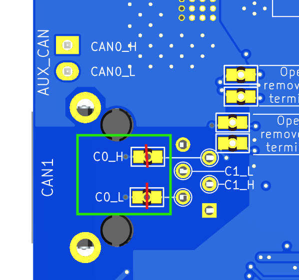

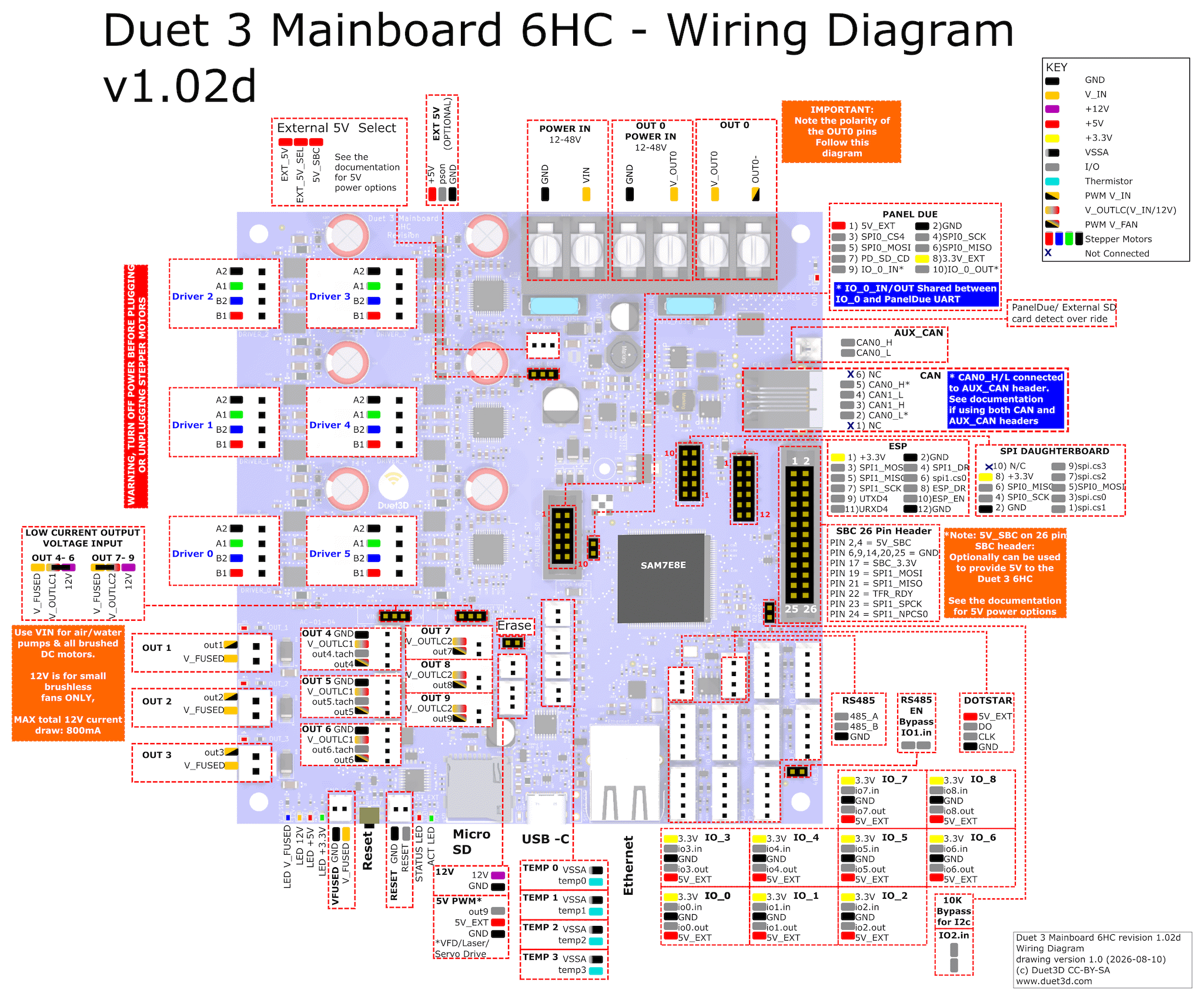

On v1.02d the AUX CAN signals (CAN0_H/L) are also connected to the main CAN RJ12 header on pins 2 and 5. See the CAN FD bus documentation below for further information

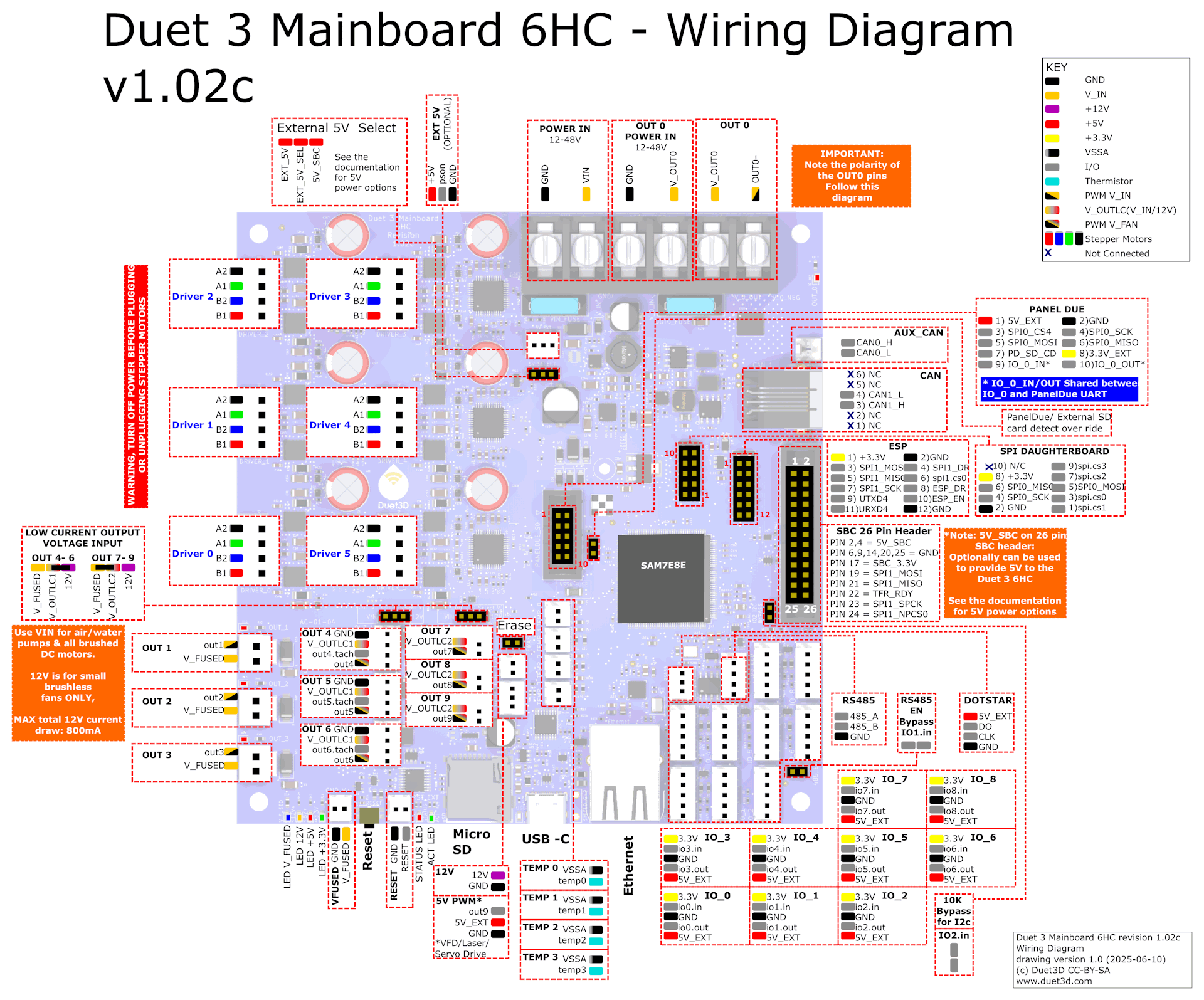

Duet 3 Mainboard 6HC provides the following connectors:
| Header | PCB label | Function |
| 1 x 6-way barrier strip | POWER IN, GND, VIN | Two pins for main VIN and GND. VIN min/max: 11V to 48V (11V to 32V before v1.02) up to 30A |
| OUT 0 POWER IN, GND, V_OUT0 | Two pins for the VIN and GND supply for the OUT_0 terminals. OUT0 voltage min/max: 0V to 48V (0V to 32V before v1.02) | |
| OUT 0, V_OUT0, OUT0- | Positive and negative OUT_0 terminals. OUT_0 is intended to drive a bed heater. The ground side of OUT_0 is switched by the mosfet and the positive side is protected by a 15A fuse. If using the OUT0 terminal to drive a SSR, take note that their polarity is opposite to the polarity of the VIN terminals. There is no flyback diode on this output, so if you connect a high-current inductive load, you must use an external flyback diode. | |
| 1 x 3-pin KK connector | EXT 5V | Open drain mosfet output for controlling an ATX-style power supply or a SSR. The +5V pin can also be used to provide a small amount of 5V power (through an internal 220 ohm resistor) so that the control terminals of an SSR can be connected directly between the +5V and PS_ON pins. |
| 1 x 3-pin KK header | 5V SELECT | v1.02 and later boards. 5V supply select, between 5V internal regulator (no jumper), 5V_EXT, and 5V_SBC. See Power distribution > 5V documentation below for details. |
| 3 x 2-pin KK headers | 5V Options | v0.6 to v1.0a boards only, not populated on v1.0a. 5V supply select. See Power distribution > 5V documentation below for details. |
| 6 x 4-pin JST VH connector | DRIVER_0, DRIVER_1, DRIVER_2, DRIVER_3, DRIVER_4, DRIVER_5 | Stepper motor connections. (see note on JST VH connectors) |
| 3 x 2-pin JST VH connector | OUT 1, OUT 2, OUT 3 | These are intended for extruder heaters or fans. The out1, out2, out3 pins are PWM switched GND, the V_FUSED pins are fused input voltage. Maximum recommended current 6A each. These outputs are protected by flyback diodes. |
| 3 x 4-pin KK connectors with offset spigot | OUT 4, OUT 5, OUT 6 | These medium current outputs are intended for PWM-controllable fans. The connector fits a standard PC-type 4-pin PWM fan. Alternatively, a 2-pin fan may be connected between the V_OUT_LC_1 pin (+ve) and the OUT_n_NEG pin (-ve). Maximum recommended current 2A each when supplied by VIN. |
| Note: These outputs are protected by a flyback diode connected to V_OUT_LC_1. Do not mix loads connected to V_OUT_LC_1 with the jumper set to 12V and loads connected to V_FUSED on the same bank. | ||
| 1 x 3-pin KK header | OUT4-OUT6_SelectV | The positive supply to the OUT 4, OUT 5 and OUT 6 connectors is the centre pin of the 3-pin jumper block labelled OUT4-OUT6_SelectV. A jumper in the top position will power them from the fused VIN supply. Alternatively you can connect a 3-terminal buck regulator to the 3-pin jumper block to supply the required voltage to the centre pin. |
| see note 1 below. | ||
| 3 x 2-pin KK connectors | OUT 7, OUT 8, OUT 9 | These are intended for fans. Maximum recommended current 2A each when supplied by VIN. |
| Note: These outputs are protected by a flyback diode connected to V_OUT_LC_2. Do not mix loads connected to V_OUT_LC_2 with the jumper set to 12V and loads connected to V_FUSED on the same bank. | ||
| 1 x 3-pin KK header | OUT7-OUT9_SelectV | The positive supply to the OUT 7, OUT 8 and OUT 9 connectors is the centre pin of the 3-pin jumper block labelled OUT7-OUT9_SelectV. A jumper in the top position will power them from the fused VIN supply. Alternatively you can connect a 3-terminal buck regulator to the 3-pin jumper block to supply the required voltage to the centre pin. |
| 1 x 2-pin KK connector | VFUSED | Always on, not switched. This is for powering an always-on fan or similar. Current limit 1.5A |
| 1 x 2-pin KK connector | RESET_EXT | For an external normally-open reset switch. |
| 1 x 2-pin KK header | ERASE | Add a jumper to erase the firmware. |
| 1 x 2-pin KK connector | 12V | Provides 12V power for a PWM to 0-10V converter. |
| 1 x 3-pin KK connector | LASER/VFD | v1.0 and later boards. This provides 5V power and a 5V level signal for a TTL-compatible input to a laser controller, a PWM-to-0 to 10V converter (for variable-frequency drives), or a servo. The control signal for this output is shared with OUT9, so don't use OUT9 if you use this connector. |

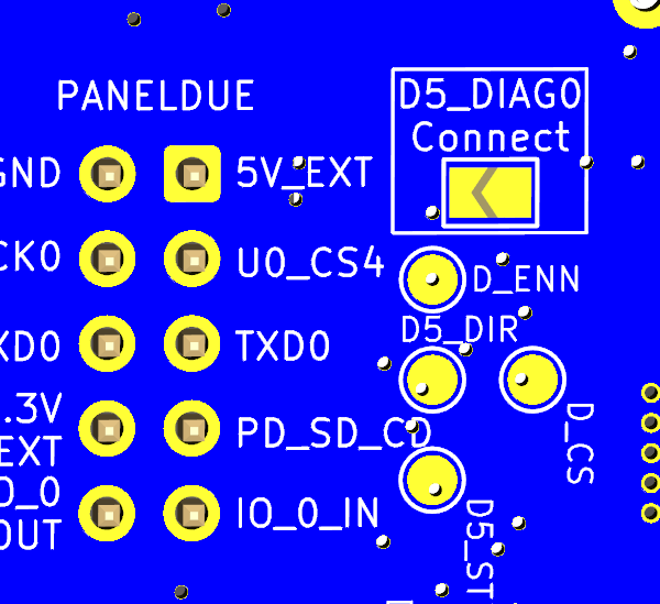

| 1 x 2x5 IDC connector | PanelDue_SD | v1.02 and later boards. Connects the PanelDue UART and shared SPI bus for external SD card. Powered from 5V supply |
| Note The PanelDue UART is shared with io0.in and io0.out pins on the IO_0 header. | ||
| see note 2 below. | ||
| 1 x 2-pin jumper | PD_CD_OVERRIDE | v1.02 and later boards. Add a jumper to connect Card Detect on the PanelDue to ground, to handle PanelDue versions that don't support Card Detect. |
| 4 x 2-pin KK connectors | TEMP_0, TEMP_1, TEMP_2, TEMP_3 | Connections for thermistor or PT1000 sensors. |
| 1 x RJ45 network connector | Ethernet | 100BaseT Port. non MDIX connect to an Ethernet switch, hub or MDIX enabled laptop port. If connecting to a non MDIX enabled port use a crossover cable. Orange LED on Ethernet port indicates Ethernet enabled, green LED indicates network activity |
| 9 x 5-pin KK connectors | IO_0, IO_1, IO_2, IO_3, IO_4, IO_5, IO_6, IO_7, IO_8 | These are for endstop switches, Z probes, filament monitors, servos, and other low-voltage I/O functions. Each connector provides both 3.3V and 5V power. The inputs will tolerate up to 30V and have 27K pullup resistors to +3.3V. The outputs are 3.3V signals levels with 470R series resistors. |
| 1 x 4-pin KK connector | DS_LED | This is to connect and power DotStar LED strips. |

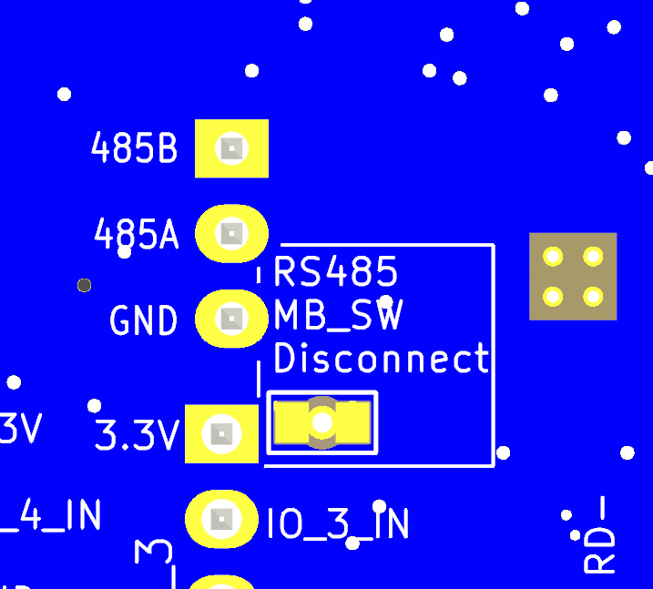

| 1 x 2-pin KK connector | RS485 | (v1.02c and later) IO1 is connected to this header via an RS485 transceiver to allow connection of RS485 devices. The RS485_EN jumper must be fitted to connect IO1.in to the RS485 transceiver. |
| 1 x 2-pin jumper | RS485 EN | Jumper to enable RS485 use by connecting IO1.in to the RS485 transceiver |
| 1 x 6-pin JST ZH (ZHR-6) connector | SWD | Only on v1.02b and earlier. Replaced with pogo pin contacts under the board from v1.02c and later. This is for firmware debugging |
| 1 x 2-pin jumper | IO2 I2C BYPASS | v1.02 and later boards. Fit this jumper to bypass the 10K resistor on io2.in. The jumper must be fitted to use IO_2 for I2C, see I2C. |
| 1 x 2x13 header | SBC | This is for connecting a single board computer (SBC) such as a Raspberry Pi. |
| 1 x 2x6 header | ESP | v1.02 and later boards: Header to connect an ESP WiFi board. |
| 1 x 2x5 header | TEMPDB | This is for connecting PT100, thermocouple and ADC daughterboards. |
| 1 x RJ11 CAN connector | CAN1_OUT | v1.02 and later boards: RJ11 connector for CAN1 (main CAN-FD bus). USE CAN1 for connecting Duet expansion boards, see CAN-FD bus expansion section below. Termination resistor fitted so normally this board must be at the end of the bus. There are drill-to-disconnect jumpers that allow the termination resistor to be removed, however this is not required in normal operation. |
| CAN_OUT | v1.01a and earlier boards and v1.02d and later boards. RJ11 CAN connector for CAN0 and CAN1. USE CAN1 (pins 3,4) for connecting Duet expansion boards, CAN0 (pins 2,5) is for future expansion; see CAN-FD bus expansion section below. On v1.01a and earlier boards a permanent termination resistor is fitted, so this board must be at one end of the CAN bus. On v1.02d and later boards there are drill-to-disconnect jumpers for the can termination resistors. On v1.02d there are also drill-to-disconnect jumpers to disconnect the CAN-0 signals if the AUX_CAN header is to be used. | |
| 1 x 2-pin KK connector | AUX_CAN | v1.02 and later boards. Secondary CAN-FD bus CAN0. From RRF 3.7.1 expansion boards can also be connected to it experimentally, see M953 P0 A. Use CAN1 for expansion boards in earlier firmware, see CAN-FD bus expansion section below. Termination resistor fitted so normally this board must be at the end of the bus. There are drill-to-disconnect jumpers that allow the termination resistor to be removed, however this is not required in normal operation. |

There are drill-to-disconnect jumpers on the bottom of the board so that they can be disconnected if there is a requirement to use the AUX_CAN header.
They should not be left connected to both headers when the AUX_CAN header is in use as the connections on the main CAN header will be a long unterminated stub.
To disconnect the termination resistors, use a small drill bit ~2mm by hand to carefully remove the connection between the two pads that is made with the ring of the copper between the pads. Do not drill all the way through the board, the copper layer is approx 70um thick (i.e. very thin!) once its removed test that the pads are actually disconnected by checking that there is no continuity between them with a multimeter.
Both jumpers must be disconnected or connected. do not do only one.

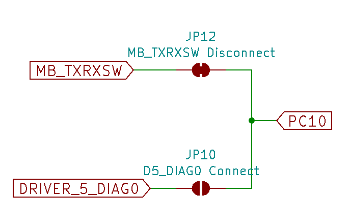

The 6HC design originally connected the DIAG outputs from the stepper motor drivers to the main processor; however this functionally is not used by RepRapFirmware as the information is available on the internal stepper driver SPI bus.
In v1.02c the Driver 5 DIAG connection was repurposed as the Transmit/Receive control of the RS485 transceiver. If you run an alternative firmware on the 6HC v1.02c or later that needs to use the diag output (e.g. for stall detection) then there is provision to connect the pin back to the diag function (note you will lose RS485 functionality).
The schematic for the connection is:
To make this change first remove the connection between MB_TXRXSW and PC10 by using a small drill bit ~2mm by hand to carefully remove the connection between the two pads that is made with the ring of the copper between the pads. Do not drill all the way through the board, the copper layer is approx 70um thick (i.e. very thin!) once its removed test that the pads are actually disconnected by checking that there is no continuity between them with a multimeter.
Then connect the DRIVER_5_DIAG0 to PC10 by bridging the jumper with solder:
check for continuity using a multimeter.
